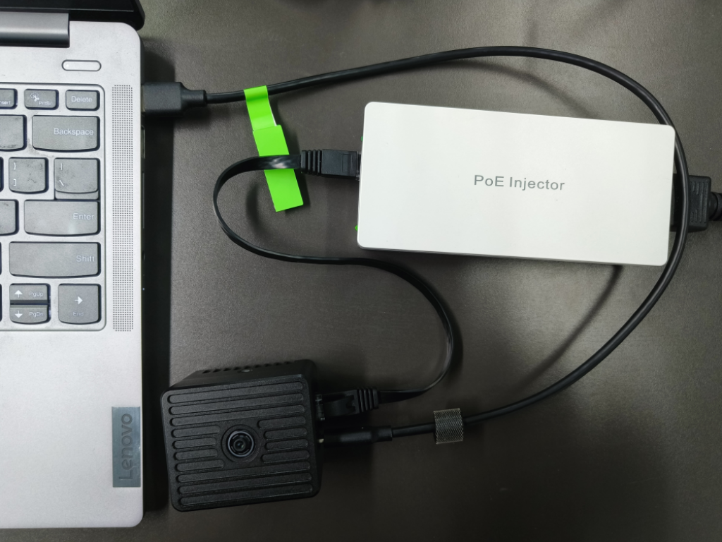

Connect Device
Connect host to all-in-one device using USB Type-C cable:
Connect Device using USB Power Connect Device using PoE Power
